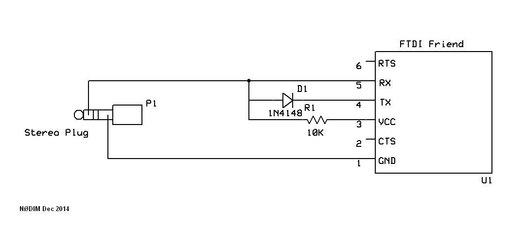

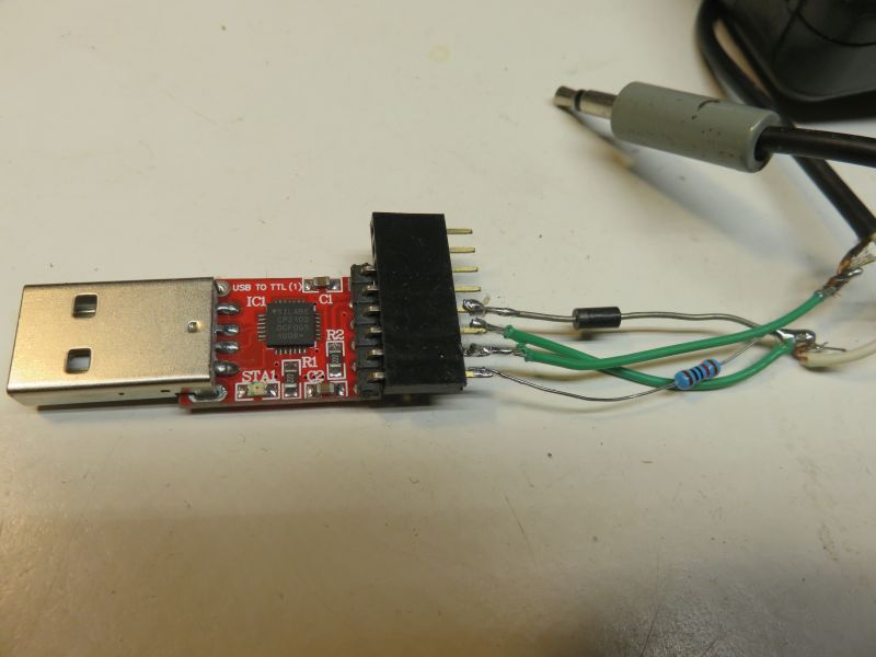

Posted by: WT9M - 12-19-2019, 06:53 AM - Forum: General discussion - Problems - Bugs / Generale - Problemi - Errori - Replies (1)
You can add this to the list of home made Icom CI-V cables .
I just made this one and it worked. I used a different kind of $2 usb to ttl board because I had one ( silicon labs CP210x is what it says )
Here is schematic - only need a resistor and diode.
Larry WT9M
