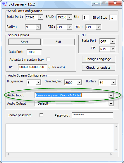

Hello BKT Server User. Today i have installed the Server option at my notebook. It works ufb !!! The problem was i have is as follow. If i have start the BKT server at the remote PC and i connect this server from my notebook, the the soundport change automaticly from Line-In to Microfone. Because i use the Line-In Port for audio from the TRX, i always must change
the soundport at the server computer manually. I cant find an option to select the audio source specifically for Line-In Port in the server software. Anybody an idea ??
73 de Harry, DH3SUP
Reply
#5
DH3SUP Wrote:Hello BKT Server User. Today i have installed the Server option at my notebook. It works ufb !!! The problem was i have is as follow. If i have start the BKT server at the remote PC and i connect this server from my notebook, the the soundport change automaticly from Line-In to Microfone. Because i use the Line-In Port for audio from the TRX, i always must change
73 de Harry, DH3SUP
Hi Harry,
try to change Audio Input.
[Image: BKTServerAudioInput.gif]
73 Mauro, IZ2BKT
73 de Mauro, IZ2BKT
