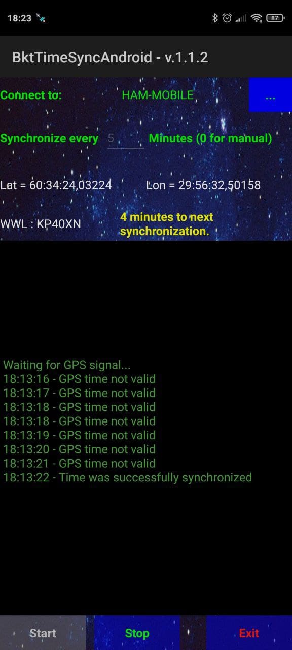

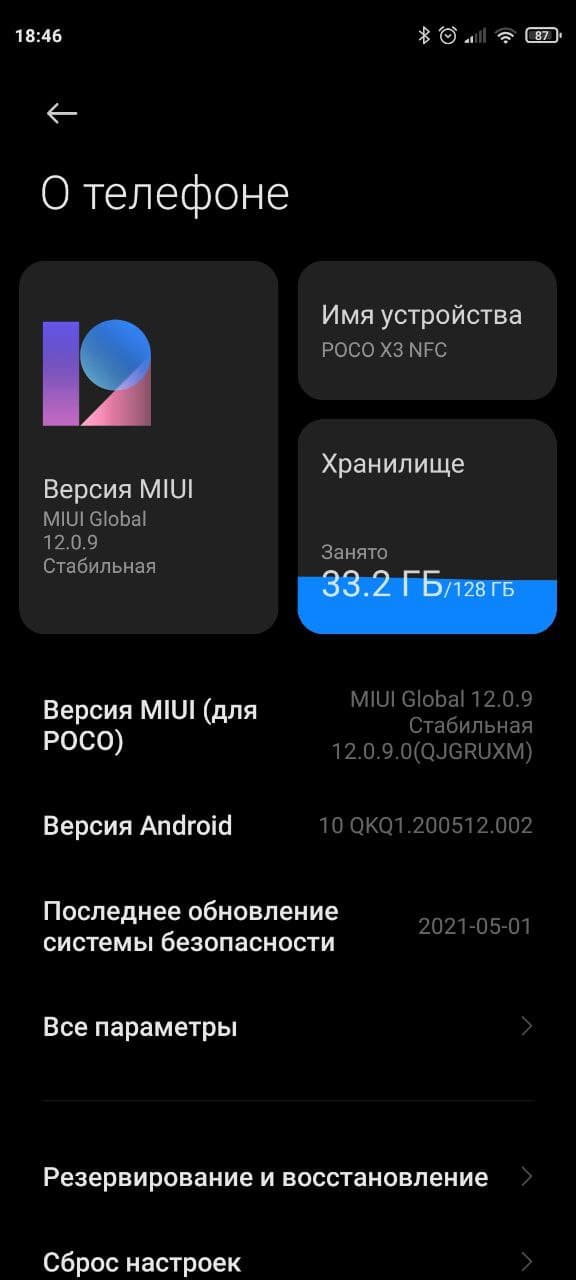

BktTimeSyncAndroid - "Synchronize every" not working - R1BET - 07-12-2021 BktTimeSyncAndroid 1.1.2 "Synchronize every" feature not working at all at my Poco X3 smartphone (Android 10). When setted number of minutes gone nothing happens. Looks like a freeze of timer in app. RE: BktTimeSyncAndroid - "Synchronize every" not working - iz2bkt - 07-13-2021 Hi, try to exclude BktTimeSyncAndroid from battery optimization RE: BktTimeSyncAndroid - "Synchronize every" not working - R1BET - 07-13-2021 (07-13-2021, 05:33 AM)iz2bkt Wrote: Hi, try to exclude BktTimeSyncAndroid from battery optimization I have done it already - didn't help. After some experiments I find out that only set option "Sleep" to "Never sleep" solve the problem. But this mode drain battery dramatically (display is always on and so on). |
