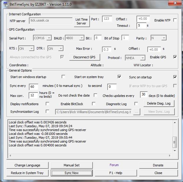

GPS Coordinates no longer shown? [SOLVED] - Rick - 05-07-2019 I am running BktTimeSynch Ver 1.11.0 and Win7 Pro - 64. When running on GPS I no longer get Coordinates, Altitude and WW Indicator displayed? The GPS synchs correctly and provides excellent time. Is this a bug in 1.11.0? 73, Rick VE7TK RE: GPS Coordinates no longer shown? - iz2bkt - 05-08-2019 With my GPS it works, please, enable the diagnostic Log and post it. Thank you
RE: GPS Coordinates no longer shown? - Rick - 05-08-2019 (05-07-2019, 05:13 PM)Rick Wrote: I am running BktTimeSynch Ver 1.11.0 and Win7 Pro - 64. Here is the file you requested. I believe it includes the startup AND a manual synch. Also it looks like the Lat , Long and Elevation info are correct. Thanks, Rick VE7TK Windows Versione: 6.01 BKTTimeSync Versione: 1.11.0 NTP Server: tick.usask.ca NTP Porta: -1 NTP Offset: NTP ON: 0 Autostart: -1 Start in tray: 1 Sync all'avvio: -1 Sync ogni: 10 minuti Sync massima: 12 ore GPS Porta: 16 GPS Baud: 4800 GPS Bit: -1 GPS Bit di stop: -1 GPS Parità: GPS RTS: -1 GPS DTR: -1 GPS Offset: GPS Always Connected: -1 Sequence: 1 Wed May 8 10:37:28 2019 --> Windows Versione: 6.01 BKTTimeSync Versione: 1.11.0 NTP Server: tick.usask.ca NTP Porta: -1 NTP Offset: NTP ON: 0 Autostart: -1 Start in tray: 1 Sync all'avvio: -1 Sync ogni: 10 minuti Sync massima: 12 ore GPS Porta: 16 GPS Baud: 4800 GPS Bit: -1 GPS Bit di stop: -1 GPS Parità: GPS RTS: -1 GPS DTR: -1 GPS Offset: GPS Always Connected: -1 Sequence: 1 Wed May 8 10:37:32 2019 --> Sync start P1 Wed May 8 10:37:32 2019 --> Wed May 8 10:37:33 2019 --> GPS rx str P1 - BuffLen=68 Wed May 8 10:37:33 2019 --> GPS rx str: $GPRMC,173733.00,A,4828.98430,N,12322.35256,W,0.026,,080519,,,D*63 Wed May 8 10:37:33 2019 --> Sync GPS OK, next to :Wed May 8 10:47:00 2019Wed May 8 10:39:36 2019 --> Sync start P1 Wed May 8 10:39:36 2019 --> GPS rx str P1 - BuffLen=68 Wed May 8 10:39:36 2019 --> GPS rx str: $GPRMC,173937.00,A,4828.98271,N,12322.35139,W,0.036,,080519,,,D*61 Wed May 8 10:39:37 2019 --> Sync GPS OK, next to :Wed May 8 10:49:00 2019Wed May 8 10:39:51 2019 --> RE: GPS Coordinates no longer shown? - Rick - 05-09-2019 It is working again? I have no idea what has changed but for some reason the Lat, Long, Elevation and Grid are back?? Thanks for your help Mauro. 73, Rick VE7TK RE: GPS Coordinates no longer shown? - iz2bkt - 05-09-2019 The problem occurs when the GPS first sends the $GPRMC string of the $GPGGA. The BktTijmeSync 1.11.1 version solves this problem. RE: GPS Coordinates no longer shown? [SOLVED] - Rick - 05-10-2019 Working again. However, the Altitude is not showing? (Since the Altitude on my cheap GPS is inaccurate I do not miss it - hi!) Thanks again Mauro. 73, Rick VE7TK RE: GPS Coordinates no longer shown? [SOLVED] - iz2bkt - 05-10-2019 The altitude is present only in the $GPGGA string which is sometimes not passed RE: GPS Coordinates no longer shown? [SOLVED] - Rick - 05-10-2019 (05-10-2019, 07:39 PM)iz2bkt Wrote: The altitude is present only in the $GPGGA string which is sometimes not passed Thanks Mauro. I just checked again and after a few hours of operation Altitude is indeed on the screen. Thanks. 73, Rick VE7TK |
