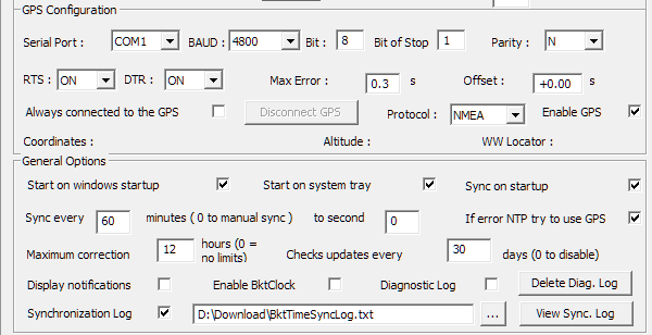

Windows "Set time automatically" setting? - n1eu - 11-19-2017 Should the Windows 10 setting 'Set time automatically" be turned on or off under "Date and time"? RE: Windows "Set time automatically" setting? - iz2bkt - 11-20-2017 Hi, Not relevant, you can leave it on. RE: Windows "Set time automatically" setting? - n1eu - 11-20-2017 Thanks Mauro. I'm using BktTimeSync on a Windows 10 Tablet along with bluetooth TomTom gps receiver and finding it very difficult to maintain a reliable time sync. If I manage to get all the modules talking with each other, I'm often seeing large time corrections (~ 1 sec) every 1 minute. The time sync doesn't seem accurate enough for WSJT-X to run FT8 mode. I'm still working on it, but very frustrating. 73, Barry N1EU RE: Windows "Set time automatically" setting? - iz2bkt - 11-20-2017 Hi Barry, The quality of GPS synchronization depends on how many satellites are used by the receiver. Try changing MAX Error and synchronizing every hour. ![]() RE: Windows "Set time automatically" setting? - n1eu - 11-20-2017 Thanks Mauro. It seems to be working much better now! |
